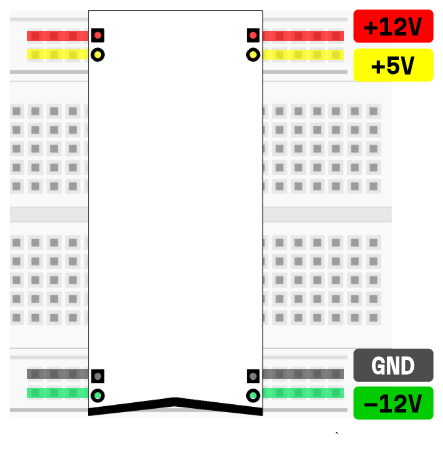

Power Supply¶
MICRORACK modules are placed on the breadboard and use the following order of voltage rails for power:
| Rail | Voltage | Purpose |
| V12+ | +12V | Positive power supply |
| V5+ | +5V | Aux positive power supply |
| GND | 0V | Ground reference |
| V12- | -12V | Negative power supply |
Middle section pins of the breadboards are not used for power distribution by MICRORACK Specification and is reserved for extending I/O signals or prototyping.
- Voltage tolerance: ±10% on all power rails
- Ripple: Up to 200 mV Vpp
Each power rail requires at least 2 pins (on both sides of the module), and it must be directly connected to each other to power adjacent modules between two breadboards.

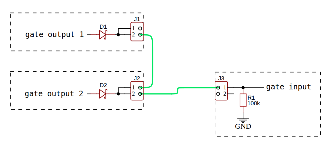

Logic Signals¶
Triggers, gates, and clock signals use the following thresholds:
- High level: ≥ 3.5V
- Low level: ≤ 0.7V
Timing requirements:
- Minimum trigger width: 100 µs (1 ms recommended)
- Maximum rise/fall time: 1 ms
Tip
It is recommended to use a Schmitt trigger for logic inputs.

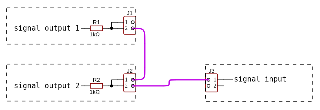

I/O Amount¶
It is recommended to put at least two pins for each signal input and sum them together. Similarly, it is recommended to put at least two pins for each signal output and duplicate the signal to both.

Alternative output configurations are permitted:
- Passive summing: Use 1 kΩ output impedance with multiple directly connected pins. This allows outputs from different modules to be summed by connecting them together.
- Wired-OR: Use open-emitter or diode-coupled outputs with multiple directly connected pins. This enables wired-OR logic between module outputs.
