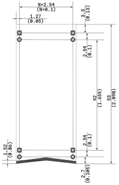

Dimensions and Outlines
PCB Outline Template for EasyEDA
MICRORACK Module Dimensions
The height of the module is 2090 mil (53 mm). If the module has connectors on the top, it is allowed to increase the height by 400 mil (10 mm).
The width of modules is not fixed. To increment the module width use formula:
(N+1) * 100 mil (2.54 mm)
Where N+1 is the number of 100 mil (2.54 mm) breadboard lines the module occupies.
Example
Module with a width of 7 lines will have a width of 6+1 * 100 = 700 mil (17.5 mm)
To easily distinguish between top and bottom of the modules, a symmetrical triangular cutout is made at the bottom. Height or "depth" of cutout is 60 mil (1.52 mm).

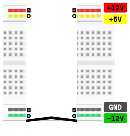

Power Contacts
Each module equipped with power contacts at the bottom layer of the board. There are two pairs of contacts on each corner of the module. They power and mount the module in a breadboard.
MICRORACK Voltage Layout
Male pin headers with a 100 mil (2.54 mm) pitch are used for power contacts. The -12V and GND contacts are located at the bottom corners of the board, while the +12V and +5V contacts are located at the top corners.
Tip
For specific use cases and firmer connection of interfaces and bigger cables double row male pin headers can be used.
The distance between the centers of the inner pins is 1655 mil (42 mm). The distance from the center of the outer pins to the edges of the board is 130 mil (3.3 mm).
It is recommended to use 0.9 mm holes for standard male pin headers
The offset of the outline from the center of the contact to the side is 50 mil (1.27 mm).
